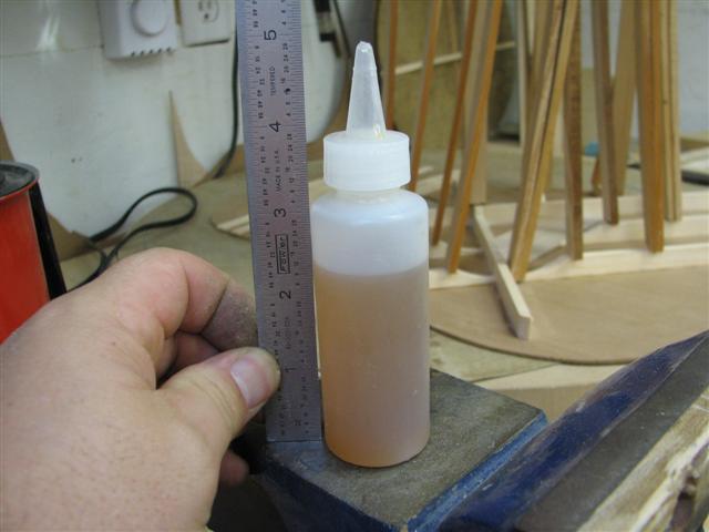

So, I've picked up the HHG bug and am liking it.
One question I have is this.
What is the life cycle of the glue once it's been heated and gelled (initial heat and cool).
How many times can it be heated than gel again. Or can it be frozen than heated than frozen again? I've made a very small amount but as you can see from my picture, didn't even use 1/4 of it.
So, now what? I've put it in the freezer and plan to use it the next time I get in the shop.
Can I just continue to freeze it over and over or will it just break down the glue and become useless?
Anyone know or can help me here?Rod True39061.9397106481

Soooo what if I just kept it in the bottle you see there with the cap on it. Frozen. I plan on using it later this week, it'll than be about 10 days old.
Man am I sounding cheap. I could just make up some more, it ain't that expensive
